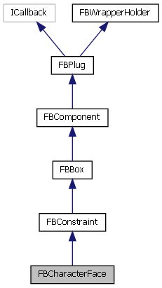

Inheritance diagram for FBCharacterFace:
