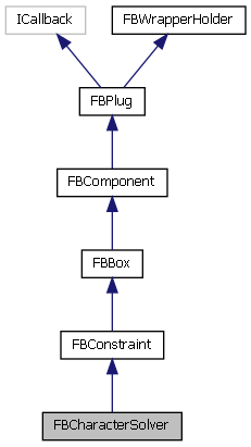

#include <fbcharactersolver.h>
Inheritance diagram for FBCharacterSolver:
