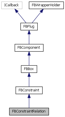

ConstraintRelation class. More...
#include <fbconstraint.h>
This class exposes the relation constraint and allows addition of new boxes and removal of existing ones.
Definition at line 453 of file fbconstraint.h.
| FBConstraintRelation | ( | const char * | pName, |
| HIObject | pObject = NULL |
Constructor.
| pName | Name of constraint. |
| pObject | For internal use only (default is NULL). |
Create a receiver box.
Use an existing FBBox object to create a receiver in the relation.
| pConstrainedObject | Destination box to insert in the constraint. |
| FBBox* CreateFunctionBox | ( | const char * | pGroup, |
| const char * | pName | ||
Create a function box.
Ask the constraint to create new function box.
| pGroup | Name of the group under which the function is located in the Constraint Relation GUI (case-sensitive!). |
| pName | Name of the function, as seen in the GUI (case-sensitive!). |
| bool GetBoxPosition | ( | FBBox * | pBox, |
| int & | pX, | ||
| int & | pY | ||
Get a box position in the GUI.
Get the position of a box within the constraint layout view.
| pBox | Box from which the information will be queried. |
| pX | X position. |
| pY | Y position. |
Create a sender box.
Use an existing FBBox object to create a sender in the relation.
| pSource | Source box to insert in the constraint. |
| bool SetBoxPosition | ( | FBBox * | pBox, |
| int | pX, | ||
| int | pY | ||
Set a box position in the GUI.
Set the position of a box within the constraint layout view.
| pBox | Box which needs to be moved. |
| pX | New X position. |
| pY | New Y position. |
| FBPropertyListBox Boxes |
List: Boxes used in this constraint.
Definition at line 505 of file fbconstraint.h.
