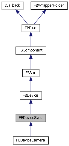

Inheritance diagram for FBDeviceSync:

Detailed Description
Sync'ed device class.
Base class for devices that are streaming data that will be accessed based upon a sync'ed stream (such as a genlock).
Definition at line 89 of file fbtracker.h.
