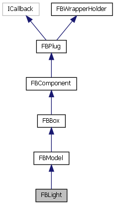

Inheritance diagram for FBLight:

Detailed Description
Light class.
Definition at line 85 of file fblight.h.
