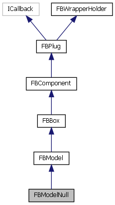

Null object class. More...
#include <fbmodel.h>
