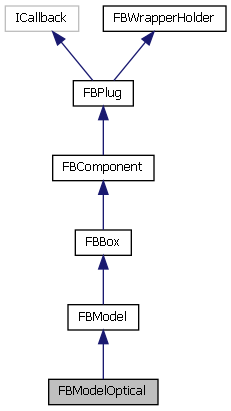

Optical model class. More...
#include <fboptical.h>
Public Member Functions | |
| FBModelOptical (const char *pName, HIObject pObject=NULL) | |
| Constructor. More... | |
| virtual bool | ImportSetup () |
| Setup importation for optical model. More... | |
| virtual bool | ExportSetup () |
| Setup exportation from optical model. More... | |
| virtual void | ClearSegments (bool pUnUsedOnly=true) |
| Clear the segments (by default only the unused). More... | |
| FBRigidBody | CreateRigidBody (const char *pRigidBodyName, FBArrayTemplate< FBModelMarkerOptical *> pMarkers) |
| Create a new rigid body from the given optical markers. More... | |

| virtual const char * | ClassName () override |
| Get the class name. More... | |
| virtual bool | UseCustomPropertyViewSet () const |
| Use the custom property viewSet or not. More... | |
| const char * | GetFullName (void) |
| Get the full name. More... | |
| void | SetOwnerNamespace (FBNamespace *pOwnerNSObj) |
| Set the owner Namespace object. More... | |
| FBNamespace * | GetOwnerNamespace (void) |
| Get the owner Namespace object. More... | |
| FBFileReference * | GetOwnerFileReference (void) |
| Get the owner FileReference object. More... | |
| void | HardSelect () |
| HardSelect. More... | |
| virtual bool | Is (int pTypeId) |
| Returns true if object is of type TypeId. More... | |
| virtual int | GetTypeId () |
| GetTypeId( int pTypeId ) More... | |
Definition at line 594 of file fboptical.h.
