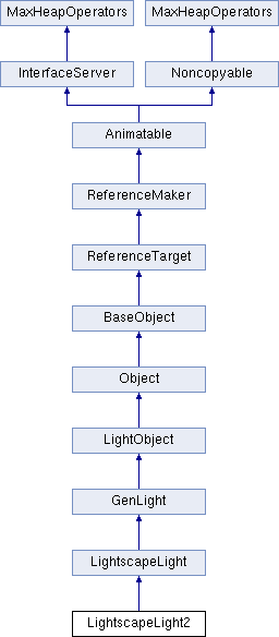

 Inheritance diagram for LightscapeLight2:
 Inheritance diagram for LightscapeLight2:| Public Member Functions | |
