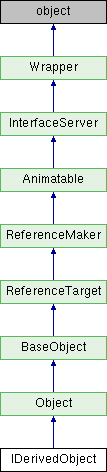

An interface to objects affected by modifiers.
