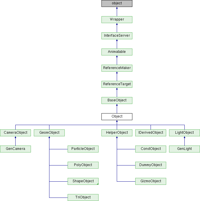

Inheritance diagram for Object:Public Member Functions | |

Base class of scene elements such as cameras, lights, helper objects, and geometric objects.

AsTriObject(Object self, TimeValue t=Autodesk::Max::Now()) -> TriObject AsTriObject(Object self) -> TriObject
| def BranchDeleted | ( | self, | |
| * | args | ||
BranchDeleted(Object self, int branchID, bool reorderChannels)
| def CanCacheObject | ( | self | ) |
CanCacheObject(Object self) -> bool
| def CanConvertToType | ( | self, | |
| * | args | ||
CanConvertToType(Object self, Class_ID obtype) -> int
Reimplemented in PolyObject.
| def CheckObjectIntegrity | ( | self | ) |
CheckObjectIntegrity(Object self) -> bool
| def CollapseObject | ( | self | ) |
CollapseObject(Object self) -> Object
| def ContainedShapeSelectionArray | ( | self | ) |
ContainedShapeSelectionArray(Object self) -> BitArray
| def ConvertToDerivedObject | ( | self | ) |
ConvertToDerivedObject(Object self) -> Object
| def ConvertToType | ( | self, | |
| * | args | ||
ConvertToType(Object self, Class_ID obtype, TimeValue t=Autodesk::Max::Now()) -> Object ConvertToType(Object self, Class_ID obtype) -> Object
| def CopyAdditionalChannels | ( | self, | |
| * | args | ||
CopyAdditionalChannels(Object self, Object other, bool deleteOld=True, bool bShallowCopy=False) CopyAdditionalChannels(Object self, Object other, bool deleteOld=True) CopyAdditionalChannels(Object self, Object other)
| def CopyChannelLocks | ( | self, | |
| * | args | ||
CopyChannelLocks(Object self, Object obj, ChannelMask needChannels)
| def DeleteAllAdditionalChannels | ( | self | ) |
DeleteAllAdditionalChannels(Object self)
| def DoOwnSelectHilite | ( | self | ) |
DoOwnSelectHilite(Object self) -> int
| def Eval | ( | self, | |
| * | args | ||
Eval(Object self, TimeValue t=Autodesk::Max::Now()) -> ObjectState Eval(Object self) -> ObjectState
Reimplemented in IDerivedObject, PolyObject, and LightObject.
| def FindBaseObject | ( | self | ) |
FindBaseObject(Object self) -> Object
| def FreeChannels | ( | self, | |
| * | args | ||
FreeChannels(Object self, ChannelMask channels)
| def GetBranchINode | ( | self, | |
| * | args | ||
GetBranchINode(Object self, TimeValue t, INode node, int i, bool selected=True) -> INode GetBranchINode(Object self, TimeValue t, INode node, int i) -> INode
| def GetChannelLocks | ( | self, | |
| * | args | ||
GetChannelLocks(Object self) -> ChannelMask GetChannelLocks(Object self, ChannelMask m) -> ChannelMask
| def GetChannelValidity | ( | self, | |
| * | args | ||
GetChannelValidity(Object self, int nchan, TimeValue t=Autodesk::Max::Now()) -> Interval GetChannelValidity(Object self, int nchan) -> Interval
| def GetContainedShape | ( | self, | |
| * | args | ||
GetContainedShape(Object self, int index, TimeValue t=Autodesk::Max::Now()) -> ShapeObject GetContainedShape(Object self, int index) -> ShapeObject
| def GetContainedShapeMatrix | ( | self, | |
| * | args | ||
GetContainedShapeMatrix(Object self, int index, Matrix3 mat, TimeValue t=Autodesk::Max::Now()) GetContainedShapeMatrix(Object self, int index, Matrix3 mat)
| def GetDeformBBox | ( | self, | |
| * | args | ||
GetDeformBBox(Object self, Matrix3 tm, bool useSel=False, TimeValue t=Autodesk::Max::Now()) -> Box3 GetDeformBBox(Object self, Matrix3 tm, bool useSel=False) -> Box3 GetDeformBBox(Object self, Matrix3 tm) -> Box3 GetDeformBBox(Object self, bool useSel=False, TimeValue t=Autodesk::Max::Now()) -> Box3 GetDeformBBox(Object self, bool useSel=False) -> Box3 GetDeformBBox(Object self) -> Box3
| def GetExtendedProperties | ( | self, | |
| * | args | ||
GetExtendedProperties(Object self, WStr prop1Label, WStr prop1Data, WStr prop2Label, WStr prop2Data, TimeValue t=Autodesk::Max::Now()) -> bool GetExtendedProperties(Object self, WStr prop1Label, WStr prop1Data, WStr prop2Label, WStr prop2Data) -> bool
| def GetNoEvalInterval | ( | self | ) |
GetNoEvalInterval(Object self) -> Interval
| def GetNumContainedShapes | ( | self | ) |
GetNumContainedShapes(Object self) -> int
| def GetNumFaces | ( | self, | |
| * | args | ||
GetNumFaces(Object self, TimeValue t=Autodesk::Max::Now()) -> bool GetNumFaces(Object self) -> bool
| def GetNumMapChannels | ( | self | ) |
GetNumMapChannels(Object self) -> int
| def GetNumMapsUsed | ( | self | ) |
GetNumMapsUsed(Object self) -> int
| def GetNumPipeBranches | ( | self, | |
selected = True |
GetNumPipeBranches(Object self, bool selected=True) -> int GetNumPipeBranches(Object self) -> int
| def GetNumPoints | ( | self | ) |
GetNumPoints(Object self) -> int
| def GetNumSurfaces | ( | self, | |
| * | args | ||
GetNumSurfaces(Object self, TimeValue t=Autodesk::Max::Now()) -> int GetNumSurfaces(Object self) -> int
| def GetNumVerts | ( | self, | |
| * | args | ||
GetNumVerts(Object self, TimeValue t=Autodesk::Max::Now()) -> bool GetNumVerts(Object self) -> bool
| def GetObjectValidity | ( | self, | |
| * | args | ||
GetObjectValidity(Object self, TimeValue t=Autodesk::Max::Now()) -> Interval GetObjectValidity(Object self) -> Interval
| def GetPipeBranch | ( | self, | |
| * | args | ||
GetPipeBranch(Object self, int i, bool selected=True) -> Object GetPipeBranch(Object self, int i) -> Object
| def GetPoint | ( | self, | |
| * | args | ||
GetPoint(Object self, int i) -> Point3
| def GetSubselState | ( | self | ) |
GetSubselState(Object self) -> DWORD
| def GetSurfacePoint | ( | self, | |
| * | args | ||
GetSurfacePoint(Object self, float u, float v, Interval iv=Autodesk::Max::Forever(), TimeValue t=Autodesk::Max::Now()) -> Point3 GetSurfacePoint(Object self, float u, float v, Interval iv=Autodesk::Max::Forever()) -> Point3 GetSurfacePoint(Object self, float u, float v) -> Point3 GetSurfacePoint(Object self, int surface, float u, float v, Interval iv=Autodesk::Max::Forever(), TimeValue t=Autodesk::Max::Now()) -> Point3 GetSurfacePoint(Object self, int surface, float u, float v, Interval iv=Autodesk::Max::Forever()) -> Point3 GetSurfacePoint(Object self, int surface, float u, float v) -> Point3
| def GetWeight | ( | self, | |
| * | args | ||
GetWeight(Object self, int i) -> double
| def GetWorldSpaceObjectNode | ( | self | ) |
GetWorldSpaceObjectNode(Object self) -> INode
| def HasWeights | ( | self | ) |
HasWeights(Object self) -> bool
| def InitNodeName | ( | self, | |
| * | args | ||
InitNodeName(Object self, WStr s)
| def IntersectRay | ( | self, | |
| * | args | ||
IntersectRay(Object self, Ray r, float & at, Point3 norm, TimeValue t=Autodesk::Max::Now()) -> bool IntersectRay(Object self, Ray r, float & at, Point3 norm) -> bool
| def InvalidateChannels | ( | self, | |
| * | args | ||
InvalidateChannels(Object self, ChannelMask channels)
| def IsBaseClassOwnedChannel | ( | self, | |
| * | args | ||
IsBaseClassOwnedChannel(Object self, int nchan) -> bool
| def IsDeformable | ( | self | ) |
IsDeformable(Object self) -> int
| def IsManipulator | ( | self | ) |
IsManipulator(Object self) -> bool
| def IsMappable | ( | self | ) |
IsMappable(Object self) -> int
| def IsObjectLocked | ( | self | ) |
IsObjectLocked(Object self) -> int
| def IsParamSurface | ( | self | ) |
IsParamSurface(Object self) -> bool
| def IsParticleSystem | ( | self | ) |
IsParticleSystem(Object self) -> bool
| def IsPointSelected | ( | self, | |
| * | args | ||
IsPointSelected(Object self, int i) -> bool
| def IsRenderable | ( | self | ) |
IsRenderable(Object self) -> int
| def IsShapeObject | ( | self | ) |
IsShapeObject(Object self) -> bool
| def IsWorldSpaceObject | ( | self | ) |
IsWorldSpaceObject(Object self) -> bool
| def LockChannels | ( | self, | |
| * | args | ||
LockChannels(Object self, ChannelMask channels)
| def LockObject | ( | self | ) |
LockObject(Object self)
| def MakeShallowCopy | ( | self, | |
| * | args | ||
MakeShallowCopy(Object self, ChannelMask channels) -> Object
| def MergeAdditionalChannels | ( | self, | |
| * | args | ||
MergeAdditionalChannels(Object self, Object other, int branchID)
| def NewAndCopyChannels | ( | self, | |
| * | args | ||
NewAndCopyChannels(Object self, ChannelMask channels)
| def NormalAlignVector | ( | self, | |
| * | args | ||
NormalAlignVector(Object self, Point3 pt, Point3 norm, TimeValue t=Autodesk::Max::Now()) -> bool NormalAlignVector(Object self, Point3 pt, Point3 norm) -> bool
| def PointSelection | ( | self, | |
| * | args | ||
PointSelection(Object self, int i) -> float
| def PointsWereChanged | ( | self | ) |
PointsWereChanged(Object self)
| def PreferredCollapseType | ( | self | ) |
PreferredCollapseType(Object self) -> Class_ID
| def ReadyChannelsForMod | ( | self, | |
| * | args | ||
ReadyChannelsForMod(Object self, ChannelMask channels)
| def ReduceCaches | ( | self, | |
| * | args | ||
ReduceCaches(Object self, TimeValue t=Autodesk::Max::Now()) ReduceCaches(Object self)
| def SetChannelLocks | ( | self, | |
| * | args | ||
SetChannelLocks(Object self, ChannelMask channels)
| def SetChannelValidity | ( | self, | |
| * | args | ||
SetChannelValidity(Object self, int nchan, Interval v=Autodesk::Max::Forever()) SetChannelValidity(Object self, int nchan)
| def SetNoEvalInterval | ( | self, | |
| * | args | ||
SetNoEvalInterval(Object self, Interval iv)
| def SetPoint | ( | self, | |
| * | args | ||
SetPoint(Object self, int i, Point3 p)
| def SetSubSelState | ( | self, | |
| * | args | ||
SetSubSelState(Object self, DWORD s)
| def SetWeight | ( | self, | |
| * | args | ||
SetWeight(Object self, int i, double const w)
| def ShallowCopy | ( | self, | |
| * | args | ||
ShallowCopy(Object self, Object fromOb, ChannelMask channels)
| def SurfaceClosedU | ( | self, | |
| * | args | ||
SurfaceClosedU(Object self, int surface, TimeValue t=Autodesk::Max::Now()) -> bool SurfaceClosedU(Object self, int surface) -> bool
| def SurfaceClosedV | ( | self, | |
| * | args | ||
SurfaceClosedV(Object self, int surface, TimeValue t=Autodesk::Max::Now()) -> bool SurfaceClosedV(Object self, int surface) -> bool
| def TopologyChanged | ( | self | ) |
TopologyChanged(Object self)
| def UnlockChannels | ( | self, | |
| * | args | ||
UnlockChannels(Object self, ChannelMask channels)
| def UnlockObject | ( | self | ) |
UnlockObject(Object self)
| def UpdateValidity | ( | self, | |
| * | args | ||
UpdateValidity(Object self, int nchan, Interval v)
| def UseSelectionBrackets | ( | self | ) |
UseSelectionBrackets(Object self) -> bool
| def UsesWireColor | ( | self | ) |
UsesWireColor(Object self) -> int
| def WSStateInvalidate | ( | self | ) |
WSStateInvalidate(Object self)
