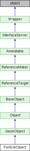

+ Inheritance diagram for ParticleObject:

Detailed Description
A particle system.
