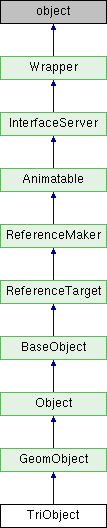

TriObject Class Reference
+ Inheritance diagram for TriObject:
