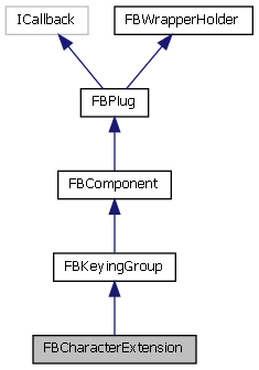

Objects Grouping class. More...
#include <fbcharacterextension.h>
This class is an interface to manipulate object's grouping in the scene.
Definition at line 127 of file fbcharacterextension.h.
