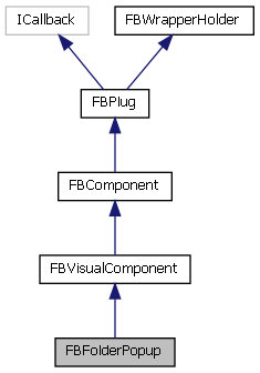

Folder Popup (for selecting a directory). More...
#include <fbcontrols.h>
Public Member Functions | |
| FBFolderPopup () | |
| Constructor. More... | |
| virtual bool | Execute () |
| Execute folder popup. More... | |
Definition at line 2044 of file fbcontrols.h.
| FBFolderPopup | ( | ) |
Constructor.
virtual |
