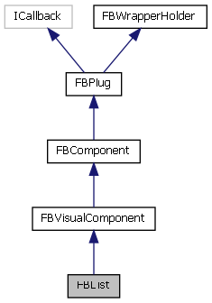

List of items. More...
#include <fbcontrols.h>
Public Member Functions | |
| FBList () | |
| Constructor. More... | |
| virtual bool | IsSelected (int pIndex) |
| Returns whether or not the item pIndex is currently selected. More... | |
| virtual void | Selected (int pIndex, bool pSelected) |
| Set the current selected state of item at pIndex to pSelected. More... | |

List of items.
Definition at line 1322 of file fbcontrols.h.
