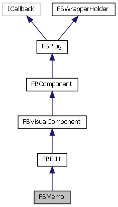

Inheritance diagram for FBMemo:

Detailed Description
Multi-line text input.
Definition at line 2124 of file fbcontrols.h.
◆ FBMemo()
FBMemo ( )
Constructor.
Member Function Documentation
◆ GetStrings()
void GetStrings ( FBStringList pLines)
Get the content of the memo.
Parameters
pLinesContent of the memo will be copied to it.
◆ SetStrings()
void SetStrings ( FBStringList pLines)
Set the content of the memo.
Parameters
pLinesContent of the memo from will be set to it.
