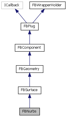

| | FBNurbs (const char *pName, HIObject pObject=NULL) |
| | Constructor. More...
| virtual void | SurfaceBegin () override |
| | Begin NURBS definition. More...
| virtual void | SurfaceEnd () override |
| | End NURBS definition. More...
| virtual void | SurfaceEditBegin () override |
| | Begin NURBS surface edition. More...
| virtual void | SurfaceEditEnd () override |
| | End NURBS surface edition. More...
| virtual void | ControlPointsBegin () override |
| | Begin NURBS control points edition. More...
| virtual void | ControlPointsEnd () override |
| | End NURBS control points edition. More...
| virtual void | SetControlWeight (int pIndex, double pWeight) |
| | Set weight of control point. More...
| virtual double | GetControlWeight (int pIndex) |
| | Get weight of control point. More...
| virtual void | SetControlMultiplicity (int pUorV, int pIndex, int pMultiplicity) |
| | Set multiplicity (number of "instances") of control point. More...
| virtual int | GetControlMultiplicity (int pUorV, int pIndex) |
| | Get multiplicity (number of "instances") of control point. More...
| virtual void | SetControlKnotValue (int pUorV, int pIndex, double pKnotValue) |
| | Set knot vector value of control point. More...
| virtual double | GetControlKnotValue (int pUorV, int pIndex) |
| | Get knot vector value of control point. More...
| virtual int | GetKnotCount (int pUorV) |
| | Number of knot vectors. More...
| | FBSurface (const char *pName, HIObject pObject=NULL) |
