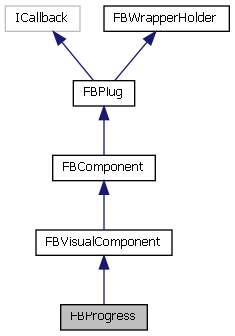

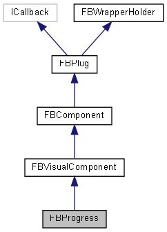

Inheritance diagram for FBProgress:

Detailed Description
Progress bar.
Definition at line 1950 of file fbcontrols.h.
◆ FBProgress()
Constructor.
Member Function Documentation
◆ ProgressBegin()
void ProgressBegin ( )
Start progress, must be called before set Text & Percent property.
◆ ProgressDone()
void ProgressDone ( )
End progress, must be called to reset progress bar UI to normal status after finishing the task.
◆ UserRequestCancell()
bool UserRequestCancell ( )
Return true if User is pressing and holding "ESC" key to request the cancellation.
Must be called in between ProgressBegin()/ProgressDone().
Member Data Documentation
◆ Caption
Read Write Property: Caption to be displayed for progress bar.
Definition at line 1969 of file fbcontrols.h.
◆ Percent
FBPropertyInt Percent
Read Write Property: Percent completed for the operation. Must be used called in between ProgressBegin()/ProgressDone()
Definition at line 1971 of file fbcontrols.h.
◆ Text
Read Write Property: Text to display on progress bar. Must be used in between ProgressBegin()/ProgressDone()
Definition at line 1970 of file fbcontrols.h.
