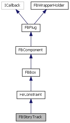

| | FBStoryTrack (FBStoryTrackType pTrackType, FBStoryFolder *pFolder=NULL, HIObject pObject=NULL) |
| | Constructor. More...
| | FBStoryTrack (FBComponent *pSource, FBStoryFolder *pFolder=NULL, HIObject pObject=NULL) |
| virtual void | FBDelete () override |
| | Virtual FBDelete function. More...
| void | ChangeDetailsBegin () |
| | ChangeDetailsBegin. More...
| void | ChangeDetailsEnd () |
| | ChangeDetailsEnd. More...
| FBStoryClip * | CopyTakeIntoTrack (FBTimeSpan &pTimeSpan, FBTake *pTake, FBTime pOutputOffset=0, bool pMakeUndoable=false) |
| | CopyTakeIntoTrack Copy animation from the specified take for affected objects of the track. More...
| void | EnableBodyPart (FBStoryTrackBodyPart pPart, bool pEnable) |
| | EnableBodyPart. More...
| bool | IsBodyPartEnabled (FBStoryTrackBodyPart pPart) |
| | IsBodyPartEnabled. More...
| void | AddClip (FBComponent *pClip, FBTime pTime) |
| | AddClip Add the clip to the track. More...
| FBStoryTrack * | CreateSubTrack (FBStoryTrackType pTrackType, FBStoryTrackRefMode pRefMode) |
| | Create a sub track, Only Character and Animation tracks can have sub-tracks. More...
| void | Load (bool pLoad) |
| | Allow to load/unload all story clips under this track. More...
| | FBConstraint (const char *pName, HIObject pObject=NULL) |
| IObject_Declare (override) |
| virtual void | ActiveChanged () |
| | Notification for Activation Status Change. More...
| virtual void | RemoveAllAnimationNodes () |
| | Remove animation nodes. More...
| virtual void | SetupAllAnimationNodes () |
| | Setup animation nodes. More...
| virtual void | SnapSuggested () |
| | Suggest 'snap'. More...
| virtual void | FreezeSuggested () |
| | Suggest 'freeze'. More...
| virtual bool | Disable (FBModel *pModel) |
| | Disable constraint on pModel. More...
| virtual bool | Enable (FBModel *pModel) |
| | Enable constraint on pModel. More...
| virtual bool | AnimationNodeNotify (FBAnimationNode *pAnimationNode, FBEvaluateInfo *pEvaluateInfo, FBConstraintInfo *pConstraintInfo) |
| | Notification callback for connectors. More...
| FBAnimationNode * | AnimationNodeOutCreate (kReference pUserId, FBModel *pModel, const char *pAttribute) |
| | Animation Node Creations (IN/OUT). More...
FBAnimationNode * | AnimationNodeInCreate (kReference pUserId, FBModel *pModel, const char *pAttribute) |
| FBAnimationNode * | AnimationNodeInCreate (kReference pUserId, FBProperty *pProperty) |
| | Animation Node Creations (IN). More...
| virtual void | SaveModelState (FBModel *pModel, bool pS, bool pR, bool pT) |
| | Save current state of pModel. More...
| virtual void | RestoreModelState (FBModel *pModel) |
| | Restore the saved model state onto pModel. More...
| virtual void | FreezeSRT (FBModel *pModel, bool pS, bool pR, bool pT) |
| | Freeze current model state. More...
| virtual FBConstraint * | Clone () |
| | Clone the constraint. More...
| int | ReferenceGroupGetCount () |
| | Return the number of reference groups. More...
| int | ReferenceGroupAdd (const char *pGroupName, int pMaxItemCount) |
| | Add a group of references. More...
| const char * | ReferenceGroupGetName (int pGroupIndex) |
| | Get the name of the reference group. More...
| int | ReferenceGroupGetMaxCount (int pGroupIndex) |
| | Get the maximum number of items that can exist in the reference group in question. More...
| FBModel * | ReferenceGet (int pGroupIndex, int pItemIndex=0) |
| | Get a reference. More...
| int | ReferenceGetCount (int pGroupIndex) |
| | Get number of references in a specified group. More...
| bool | ReferenceAdd (int pGroupIndex, FBModel *pModel) |
| | Add a reference to a specified group. More...
| bool | ReferenceRemove (int pGroupIndex, FBModel *pModel) |
| | Remove a reference to pModel from the group at pGroupIndex. More...
| void | ReferenceRemoveAll () |
| | Remove All References. More...
| virtual bool | ReferenceAddNotify (int pGroupIndex, FBModel *pModel) |
| | Notification callbacks for when a reference is added or removed. More...
virtual bool | ReferenceRemoveNotify (int pGroupIndex, FBModel *pModel) |
| virtual bool | DeformerPreNotify (FBModel *pModel, FBEvaluateInfo *pEvaluateInfo, FBVertex *pBBoxMin, FBVertex *pBBoxMax) |
| | Deformation pre-notification function This function pass the evaluation information for deformation (if timing is required). More...
| virtual bool | DeformerNotify (FBModel *pModel, const FBVertex *pSrcVertex, const FBVertex *pSrcNormal, int pCount, FBVertex *pDstVertex, FBVertex *pDstNormal) |
| | Deformation notification function. More...
| virtual bool | DeformerBind (FBModel *pModel) |
| | Bind/Unbind pModel to deformation constraint. More...
virtual bool | DeformerUnBind (FBModel *pModel) |
| virtual bool | FbxStore (FBFbxObject *pFbxObject, kFbxObjectStore pStoreWhat) override |
| | Store/Retrieve data to/from FBX files. More...
virtual bool | FbxRetrieve (FBFbxObject *pFbxObject, kFbxObjectStore pStoreWhat) override |
| | FBBox (const char *pName, HIObject pObject=NULL) |
| virtual FBAnimationNode * | AnimationNodeInCreate (kReference pUserId, const char *pName, const char *pDataType, bool pIsPublic=false, double *pMin=NULL, double *pMax=NULL, bool pUserData=false) |
| | Creation of IN/OUT Animation Nodes. More...
virtual FBAnimationNode * | AnimationNodeOutCreate (kReference pUserId, const char *pName, const char *pDataType, bool pIsPublic=false, double *pMin=NULL, double *pMax=NULL, bool pUserData=false) |
| virtual bool | EvaluateAnimationNodes (FBEvaluateInfo *pEvaluateInfo) |
| | Evaluation of non TRS nodes that needs to be evaluated. More...
| virtual bool | AnimationNodeNotify (FBAnimationNode *pAnimationNode, FBEvaluateInfo *pEvaluateInfo) |
| | Notification function for animation thread. More...
| virtual bool | ResolveCandidate (FBAnimationNode *pAnimationNode, FBEvaluateInfo *pEvaluateInfo) |
| | Function is call when candidate needs to be resolved (like global to local). More...
| virtual ECandidateAction | SetGlobalCandidate (FBAnimationNode *pAnimationNode, double *pData, FBEvaluateInfo *pEvaluateInfo) |
| | Function is call when a global candidate is set on an animation node. More...
| virtual ECandidateAction | SetStdCandidate (FBAnimationNode *pAnimationNode, double *pData, FBEvaluateInfo *pEvaluateInfo) |
| | Function is call when a non-global candidate is set on an animation node. More...
| virtual bool | AnimationNodeDestroy (FBAnimationNode *pAnimationNode) |
| | Destroy an animation node. More...
| virtual bool | AnimationNodeIsUserData (FBAnimationNode *pAnimationNode) |
| | Is the animation node user data? More...
| virtual void | AnimationNodesOutDisableIfNotWritten (FBEvaluateInfo *pEvaluateInfo) |
| | This call will disable all out animation nodes from being pull by system (animation thread) for given pEvaluateInfo. More...
| virtual FBAnimationNode * | AnimationNodeInGet () |
| | Get the (IN/OUT) animation node for this box. More...
virtual FBAnimationNode * | AnimationNodeOutGet () |
| virtual const char * | FbxGetObjectSubType () |
| | returns UniqueName if not overloaded. More...
| virtual const char * | FbxGetObjectType () |
| | Object Type "Box". More...
| virtual int | GetOutConnectorCount () const |
| | Get the number of animation node outputs for this box. More...
| virtual int | GetInConnectorCount () const |
| | Get the number of animation node inputs for this box. More...
| virtual FBAnimationNode * | GetOutConnector (int pIndex) const |
| | Get the animation node output associated with the given index. More...
| virtual FBAnimationNode * | GetInConnector (int pIndex) const |
| | Get the animation node input associated with the given index. More...
| | FBComponent (HIObject pObject) |
| virtual | ~FBComponent () |
| | Destructor. More...
| virtual bool | FBCreate () |
| | Open Reality Creation function. More...
| virtual void | FBDestroy () |
| | Open Reality destruction function. More...
| virtual bool | SetHIObject (HIObject pObject, bool pSDKComponent) override |
| | Assign component to an internal pointer. More...
| virtual int | PropertyAdd (FBProperty *pProperty) |
| | Add a property to the component's property manager. More...
| bool | PropertyAddReferenceProperty (FBProperty *pReferenceProperty) |
| | Add a reference property to the component's property manager. More...
| void | PropertyRemove (FBProperty *pProperty) |
| | Remove a Property from the component's Property manager. More...
| void | PropertyGetModifiedList (FBArrayTemplate< FBProperty * > &pPropList, FBPlugModificationFlag pModificationFlags) |
| | Get list of properties which have been modified since last loading. More...
| FBProperty * | PropertyCreate (const char *pName, FBPropertyType pType, const char *pDataType, bool pAnimatable, bool pIsUser=false, FBProperty *pReferenceSource=NULL) |
| | Create user or dynamic property. More...
| FBObjectFlag | GetObjectFlags () |
| | Get all Object Flags (concatenated). More...
| void | SetObjectFlags (FBObjectFlag pFlags) |
| | SetObjectFlags. More...
| bool | HasObjectFlags (FBObjectFlag pFlags) |
| | Check whether a specific object flag is enabled. More...
| void | EnableObjectFlags (FBObjectFlag pFlags) |
| | Enable a specific Object Flags. More...
| void | DisableObjectFlags (FBObjectFlag pFlags) |
| | Disable a specific Object Flags. More...
| void | SetObjectStatus (FBObjectStatus pStatus, bool pValue) |
| | Enable/Disable a specific Object Status. More...
| bool | GetObjectStatus (FBObjectStatus pStatus) |
| | Check to see if an object status is enabled. More...
| bool | ProcessNamespaceHierarchy (FBNamespaceAction pNamespaceAction, const char *pNamespaceName, const char *pReplaceTo=NULL, bool pAddRight=true) |
| | ProcessNamespaceHierarchy. More...
| bool | ProcessObjectNamespace (FBNamespaceAction pNamespaceAction, const char *pNamespaceName, const char *pReplaceTo=NULL, bool pAddRight=true) |
| | ProcessObjectNamespace. More...
| virtual const char * | ClassName () override |
| | Get the class name. More...
| virtual bool | UseCustomPropertyViewSet () const |
| | Use the custom property viewSet or not. More...
| const char * | GetFullName (void) |
| | Get the full name. More...
| void | SetOwnerNamespace (FBNamespace *pOwnerNSObj) |
| | Set the owner Namespace object. More...
| FBNamespace * | GetOwnerNamespace (void) |
| | Get the owner Namespace object. More...
| FBFileReference * | GetOwnerFileReference (void) |
| | Get the owner FileReference object. More...
| void | HardSelect () |
| | HardSelect. More...
| virtual bool | Is (int pTypeId) override |
| | Returns true if object is of type TypeId. More...
| virtual int | GetTypeId () override |
| | GetTypeId( int pTypeId ) More...
| FBScriptWrapper * | GetWrapper () |
| | Return the wrapper interface of this FBObject. More...
void | AddWrapper (FBScriptWrapper *) |
void | RemoveWrapper (FBScriptWrapper *) |
| enum | ECandidateAction {
eCandidateAccept,
eCandidateIntercept,
eCandidateInterceptAfterEvaluation
| | Resolving action for candidates. More...
| static int | GetInternalClassId () |
static void | FBComponentSetName (FBComponent *pObject, const char *pName) |

Story Track class.
Tracks are containers for clips (medias), have a specific type which offer different functions. Note: To change the travelling node of a track, search for the "TravellingNode" property on the track and then connect/disconnect the appropriate object. Python example: lPropTravellingNode = lAnimTrack.PropertyList.Find("TravellingNode") lCube.ConnectDst(lPropTravellingNode)
Definition at line 642 of file fbstory.h.
