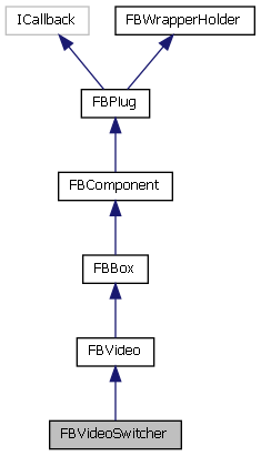

| | FBVideoSwitcher (const char *pName=NULL, HIObject pObject=NULL) |
| | Constructor. More...
| virtual void | ResetVideoSwitcher () |
| | Reset the video switcher (clear all clips). More...
| virtual void | FinishCurrentVideo () |
| | Finish the current video. More...
| virtual void | PrepareNextFrame () |
| | Prepare the next frame. More...
| virtual void | SwapCurrent (FBVideo *pVideo) |
| | Swap the current video. More...
| virtual void | SetNextClip (FBVideo *pVideo, FBPlayMode pMode) |
| | Set the next clip. More...
virtual bool | IsSDKSwitcher () |
