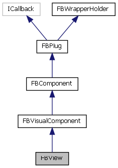

Generic view. More...
#include <fbcontrols.h>
Public Member Functions | |
| FBView () | |
| Constructor. More... | |
| IObject_Declare (override) | |
| bool | CreatePBuffer () |
| Create an OpenGL pbuffer. More... | |
| virtual void | Refresh (bool pNow=false) override |
| Refresh view. More... | |
| virtual bool | IsView () override |
| Checks if object is a view. More... | |
| virtual void | DrawString (const char *pText, float pX, float pY, int pEnable=-1) |
| Draw a string in the view. More... | |
| virtual bool | SetViewport (int pX, int pY, int pW, int pH) |
| Set view's viewport. More... | |

Generic view.
Definition at line 1899 of file fbcontrols.h.
