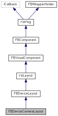

Camera device layout. More...
#include <fbdevicelayout.h>
Definition at line 176 of file fbdevicelayout.h.
