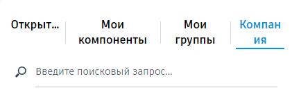

Dataset Filters and Selection
Specify the data to bring into Civil 3D by browsing available datasets for the selected area of interest using the Public, My Content, My Groups, and Organization filters.
Select the check box on the dataset you want to bring into Civil 3D if you want to select all the layers in the dataset.
If you want to manually select the layers to import, click on the tile for the dataset but do not select the check box. Then select the individual layers to import from the list that is displayed to the right.
