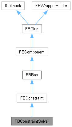

Base class for constraint solver. More...
#include <fbconstraint.h>
