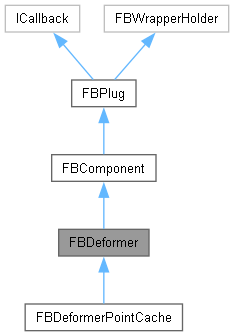

FBDeformer Class Reference
Base Model deformer class. More...
#include <fbmodel.h>
Inheritance diagram for FBDeformer:
