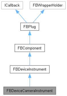

Inheritance diagram for FBDeviceCameraInstrument:
