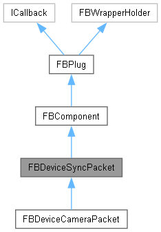

Inheritance diagram for FBDeviceSyncPacket:

Detailed Description
Sync'ed device packet.
Data packet base class for packets that correspond to a device that is timestamping the data in order to genlock the application to an incoming data stream.
Definition at line 70 of file fbtracker.h.
