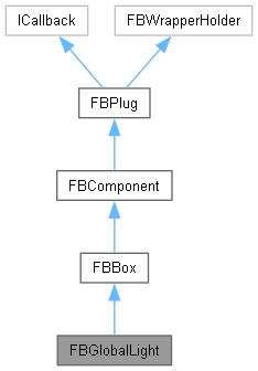

Inheritance diagram for FBGlobalLight:

Detailed Description
Global light class.
Definition at line 166 of file fblight.h.
