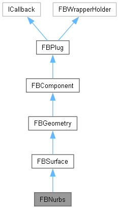

| | FBNurbs (const char *pName, HIObject pObject=NULL) |
| | Constructor.
| virtual void | SurfaceBegin () override |
| | Begin NURBS definition.
| virtual void | SurfaceEnd () override |
| | End NURBS definition.
| virtual void | SurfaceEditBegin () override |
| | Begin NURBS surface edition.
| virtual void | SurfaceEditEnd () override |
| | End NURBS surface edition.
| virtual void | ControlPointsBegin () override |
| | Begin NURBS control points edition.
| virtual void | ControlPointsEnd () override |
| | End NURBS control points edition.
