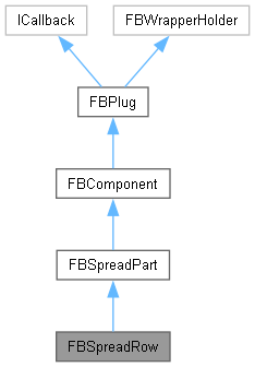

Spreadsheet row. More...
#include <fbcontrols.h>
Public Member Functions | |
| FBSpreadRow (FBSpread *pParent, kReference pRow) | |
| Constructor. | |
| virtual void | Remove () |
| Remove (destroy) row. | |
| virtual bool | EditCaption () |
| Edit the row caption. | |

Spreadsheet row.
Definition at line 1479 of file fbcontrols.h.
| FBSpreadRow | ( | FBSpread * | pParent, |
| kReference | pRow | ||
Constructor.
| pParent | Parent spreadsheet. |
| pRow | User-defined reference to assign to row. |
virtual |
This will initiate the UI edit of a row caption.
virtual |
| FBPropertyString Caption |
Read Write Property: Caption to display with row.
Definition at line 1497 of file fbcontrols.h.
| FBPropertykReference Parent |
Read Write Property: Parent of row (reference).
Definition at line 1498 of file fbcontrols.h.
| FBPropertyBool RowSelected |
Read Write Property: Is row selected?
Definition at line 1499 of file fbcontrols.h.
| FBPropertyBool RowVisible |
Read Write Property: Is row visible? Set to true to show the row, false to hide the row.
Definition at line 1500 of file fbcontrols.h.
