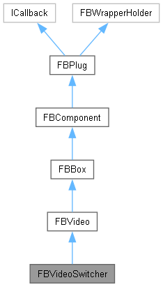

Inheritance diagram for FBVideoSwitcher:
