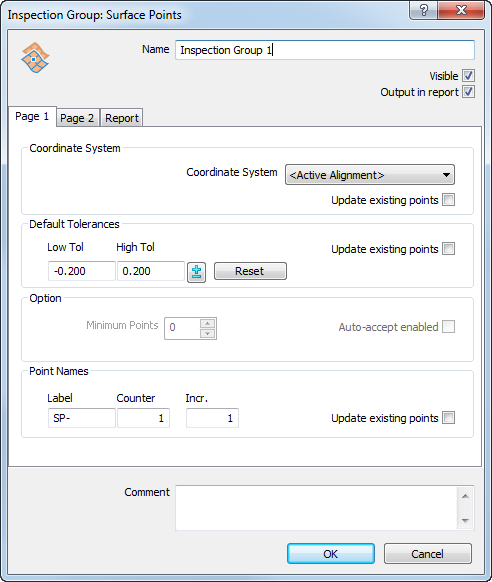

To edit a Guided Surface Points group
Use the Inspection Group: Surface Points dialog to specify the details of a Guided Surface Points group.
Note: Guided Surface Points are available only when creating inspections for CNC and Manual machines.
To display the dialog, double-click the group's name in the Sequence Tree.
The dialog contains the following settings:
Name — Enter a name for the item. The name is used in the inspection sequence, in the Report and Info tabs, and when referencing the item in other items.
Visible — Select this check box to display the item in the CAD view.
Output in report — Select this check box to include the item in the report.
Coordinate system — Select the alignment relative to which the item's measurements are to be reported.
To specify the alignment during the inspection, select <Active Alignment>. You can then select the alignment from the Active alignment list, or by adding an Active Alignment item to the inspection sequence.
Update existing points — Select this check box to apply the selected coordinate system to items already in the group.
Default tolerances — Enter the maximum distances from the nominal surface at which points are in tolerance. Select the Update existing points check box to apply the values to points already in the group.
Select Reset to revert to the defaults specified in the Measure Parameters dialog.
Point names — Enter a Label, Counter, and Incr to control the naming of points added to the group. Select the Update existing points check box to apply the rules to points already in the group.
Select the Update existing points check box to apply the changes to existing points. For example:
Comment — Enter any notes and extra information about the group.
Default offset — Enter a value if you want to compensate for surface thickness. The value can be used to compensate for the thickness of the pressing (usually a positive value), or the spark gap for an electrode (usually a negative value). The offset is applied normal to the surface at the probed point, with positive values in the direction of the probe.
Select the Update existing points check box to apply the offset to points already in the group. Select Reset to revert to the defaults specified in the Measure Parameters dialog.
Note: To specify different tolerances and offsets for individual points, double-click their entries in the inspection sequence.
Custom levels — By default, PowerInspect projects the inspection points onto the nearest surface. To exclude surfaces from use, select the Use custom levels check box, and click Levels. Select the Update existing points check box to apply the exclusions to points already in the group.
To specify the surfaces that can be used for this group:
    1. Select the Use custom levels check box, and then click the Levels button. The CAD Object Selection dialog is displayed.
    2. Click to expand the folders and display the CAD level and object entries.
    3. Select the check boxes of the entries you want to make available for inspection; deselect the check boxes to exclude them from inspection.
    4. Click OK to save your changes and close the dialog.
    5. Select the Update existing points check box to apply the level selection to points already in the group.
Waviness — Waviness describes the widely spaced irregularities that can result from problems with the manufacturing process, for example, machine vibration. For each point, PowerInspect calculates the difference between the highest and lowest surrounding points within a specified diameter. It then reports the number of differences lying within a specified maximum value as a percentage of the total points: the higher the percentage waviness, the smoother the surface.
Note: To enable PowerInspect to calculate the percentage waviness, you must select the Calculate waviness check box in the Inspection Point tab of the Measure Parameters dialog.
Enter the:
Report — Select this tab to specify the layout settings of the inspection group in the report: Select:
Click OK to close the dialog and save your changes.
