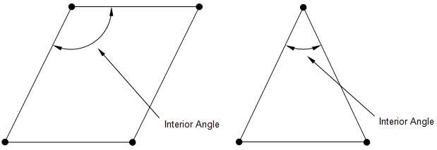

Figure 1. Interior Angle Check.

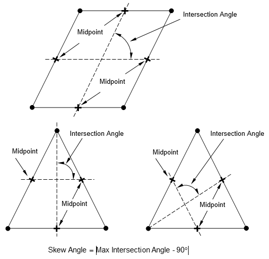

Figure 2. Skew Angle Check.

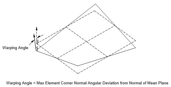

Figure 4. Warping Angle Check.

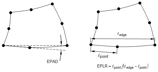

Figure 5. Edge-Point Angular Deviation and Length Ratio Checks.

| HEX_WARP | HEXFACEWARPTOL | Hex element face warping angle (degrees). | 45.0 |
| HEX_EPAD | HEXMAXEPADTOL | Hex element maximum edge-point angular deviation (degrees). | 30.0 |
| HEX_EPLR | HEXMINEPLRTOL | Hex element minimum edge-point length ratio. | 0.5 |

Skew angle for a quadrilateral element or solid element face is a measure of how much of a parallelogram it is relative to a rectangle. It is defined to be the angle between the lines that join midpoints of the opposite sides of the quadrilateral minus 90 degrees. A rectangle would have a zero skew angle. Skew angle for a triangular element or solid element face is a measure of how close it is in shape relative to an equilateral triangle. Skew angle for the triangular element is defined to be the angle between the lines that join midpoints of two opposite sides relative to the line through their vertex and the midpoint of the remaining side minus 90 degrees. An equilateral triangle would have a zero skew angle. Each vertex of the triangle is examined and the largest skew angle reported. Element accuracy can be sensitive to element skew angle.
