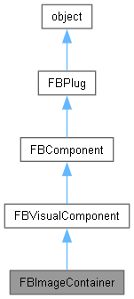

Inheritance diagram for FBImageContainer:
