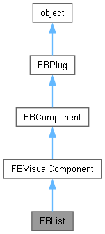

Inheritance diagram for FBList:
Public Member Functions
