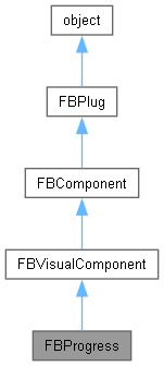

Progress bar.b>Property: Base property class. More...
#include <pyfbsdk_generated.h>
See samples: 3dsMaxBipedTemplate.py, MirrorPoseOverTime.py, FBProgress.py.
A property is a holder for function callbacks into the internals of the application.You cannot instantiate FBProperty objects. To reference a property: Use an instance of an FBComponent object. The methods FBComponent::PropertyCreate and FBComponent::PropertyRemove can be used to modify an object's set of properties. When accessing a FBProperty object via its containing object, you can get or set (assuming it is not read-only) its value directly, for example in Python: myObject.Visibility = True. FBPropertyManager exists in all FBComponent objects, and contains an array of all the registered properties. Use FBProperty::Find to find a property by name. When accessing a property reference directly, its value is obtained via its 'Data' member.
To see how to create a custom property in Python, see CustomProperty.py.
