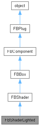

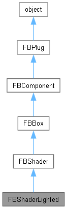

Inheritance diagram for FBShaderLighted:
