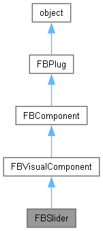

Slider. More...
#include <pyfbsdk_generated.h>
Public Member Functions | |
| FBSlider () | |
| Constructor. | |
Public Member Functions inherited from FBVisualComponent | |
| FBVisualComponent () | |
| Constructor. | |

Public Member Functions inherited from FBComponent | |
| FBComponent () | |
| Constructor. | |

Public Attributes inherited from FBPlug | |
| str | ClassGroupName |
| ClassGroupName of the object. | |
| int | TypeInfo |
| TypeInfo. | |
