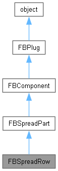

Spreadsheet row. More...
#include <pyfbsdk_generated.h>

Public Member Functions inherited from FBComponent | |

Public Attributes inherited from FBSpreadPart | |

Public Attributes inherited from FBComponent | |

Public Attributes inherited from FBPlug | |

Spreadsheet row.
| FBSpreadRow | ( | FBSpread | pParent, |
| kReference | pRow | ||
Constructor.
| pParent | Parent spreadsheet. |
| pRow | User-defined reference to assign to row. |
