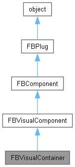

Used to create a container for a tool UI. More...
#include <pyfbsdk_generated.h>
