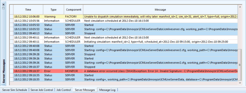

Server Messages Window
This window contains a read-only grid with messages generated from the Innovyze Live Server. The window is displayed in the middle of the Overview Page beneath the GeoPlan Window.
To display the window, select Server messages from the Window menu.
Show me
When the grid is loaded, server messages are displayed in the reverse order in which they are written to the event log by the server (most recently written messages are at the top of the grid), which broadly corresponds to the order (date and time) in which they occurred.

The colour coding identifies at a glance the message type:
Server message colour coding
