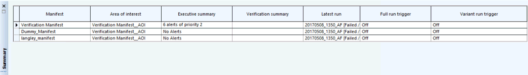

Summary Window
This window displays a list of the area of interest polygons for each manifest contained in the current Manifest Deployment as well as an alert executive summary. The window is displayed in the middle of the Overview Page beneath the GeoPlan Window.
To display the window, click the Summary tab in the middle of the Overview page, or select Summary from the Window menu.
To view all the alerts that occurred during the simulation, see the Alerts Window.
The Summary window displays data in a grid for the most recent automatic run for each manifest present in the current manifest deployment. This data is updated as new automatic runs are completed. The executive and verification summaries contains the number of alerts within each alert category that have occurred for each simulation or verification run within the given Area of Interest. The grid also indicates the status of a triggered run (full or variant) in each manifest.
Summary Window
From the grid, you can open a manifest in the Network Page, with the appropriate Area of Interest displayed (zoomed-in) on the GeoPlan Window. Right-click anywhere on the row which contains the manifest you want to view, and select Open manifest from the context menu.

Window description
Field Description
Manifest The name of the manifest present in the current manifest deployment. The manifest is defined in InfoWorks ICM Ultimate or ICMLive Configuration Manager.
Area of interest
Name of the polygon, as set in InfoWorks ICM Ultimate or ICMLive Configuration Manager.
Executive summary
Number of occurrences of an alert within the area of interest, followed by the alert category. These are the occurrences of the alerts specified in the default alert definition list in the manifest.
Note: If no Alert Categories have been defined in InfoWorks ICM Ultimate or ICMLive Configuration Manager, only the total number of alerts within the Area of Interest is displayed.
Verification summary
Number of occurrences of an alert within the area of interest, followed by the alert category. These are the occurrences of the alerts specified in the verification alert definition list in the manifest.
Latest run
Latest automatic run for the area of interest.
This information is automatically updated. However it is possible for users to manually update tit by clicking on the Refresh button of the Overview toolbar or selecting the Refresh option of the File menu.
Full run trigger
Full run and variant run triggers are set in ICMLive Configuration Manager and these fields displays their statuses for this particular manifest.
  • Off - Indicates that the trigger is turned off.
  • Date / Time - A date/time string which shows the date and time when the trigger will expire.
  • Set Indefinitely - Indicates that a trigger has occurred, and that this trigger has either no expiry date set for it in InfoWorks ICM Ultimate or ICMLive Configuration Manager or that a user has manually set the alert trigger in InfoWorks ICM Ultimate or ICMLive Configuration Manager.
Variant run trigger
