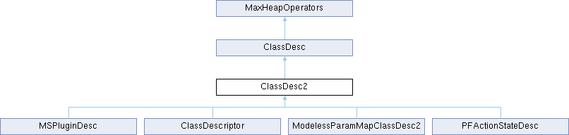

ClassDesc2 Class Reference
#include <C:/adskgit/3dsmax/3dsmax/3dswin/src/maxsdk/include/iparamb2.h>
Inheritance diagram for ClassDesc2:
