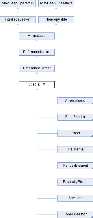

SpecialFX Class Reference
#include <C:/adskgit/3dsmax/3dsmax/3dswin/src/maxsdk/include/sfx.h>
Inheritance diagram for SpecialFX:

Detailed Description
See also
Class ReferenceTarget, Class SFXParamDlg, Class IRendParams, Class Atmospheric, Class Effect, Class AppendGizmoRestore, Class DeleteGizmoRestore.
Description:
This is the base class for Atmospheric, Renderer Effect, and Shader Plug-Ins. It contains a few methods common to each of those plug-in classes.
Data Members:
MSTR name;
This is the name which appears in Track View.
Member Function Documentation
◆ GetName()
virtual MSTR GetName ( bool localized) const
