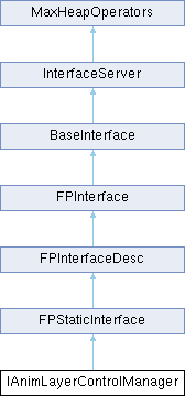

Inheritance diagram for IAnimLayerControlManager:
