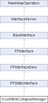

Inheritance diagram for ICustAttribCollapseManager:
