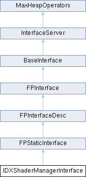

Inheritance diagram for IDXShaderManagerInterface:
