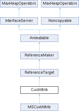

CustAttrib Class Reference
#include <C:/adskgit/3dsmax/3dsmax/3dswin/src/maxsdk/include/custattrib.h>
Inheritance diagram for CustAttrib:

Detailed Description
See also
Class ICustAttribContainer, Class ReferenceTarget, Class ParamDlg, Class Animatable
Description:
This class represents the Custom Attributes.
