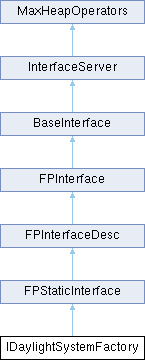

Inheritance diagram for IDaylightSystemFactory:
