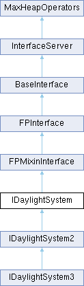

Inheritance diagram for IDaylightSystem:
